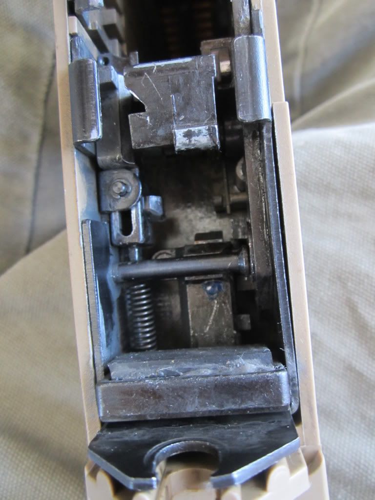

I pull back the hammer (or cock back the bolt. It does the same thing when the gun is assembled/disassembled), pull the trigger, nothing. The hammer doesn't release.
Below is some picture of the hammer/area around the hammer. Let me know if you need a video, more pictures, more info, etc.
Thanks for your help.

It means the bolt is not fully closed.  The spring at the bottom left in both pictures can sometimes be stretched a little bit to help with this problem, although that may void the warranty.

It does it even when the bolt is not on the gun. Does the bolt have to be on the gun for it to function properly?

Yes, put it all back together and see if the problem fixes itself.  If it doesn't then stretch the spring as dobey described.

Thanks, guys. I got it working.
