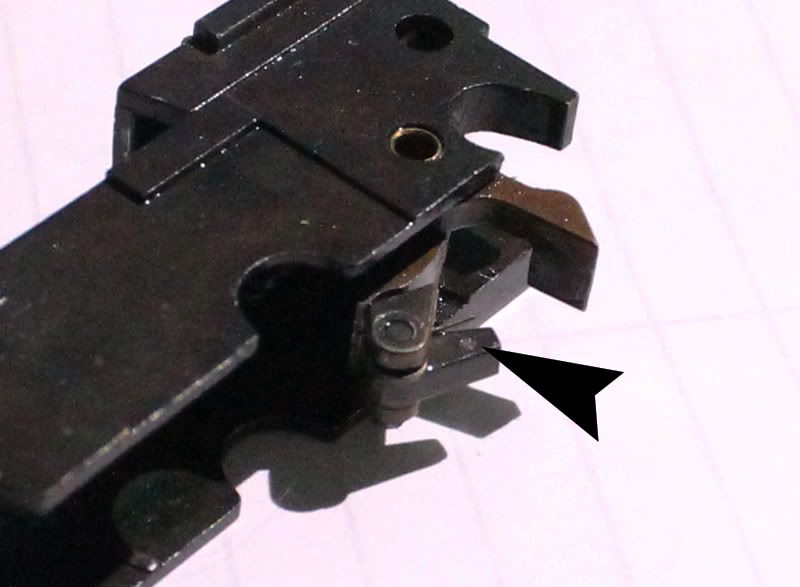

I just ran into a MKIV with this problem.  The little pin cast into the side of the bar that hits the valve broke off, and so the little spring has nothing to sit on anymore.  This makes the part not reset, and the gun wont fire.  I will have plenty of pictures of the problem in a little while.
#7 dobey
dobey
  • 234 posts
  • Location:NY
Posted 26 March 2012 - 02:15 PM
Here is a picture of the offending part :P

The most common reason for this piece breaking is dry firing the pistol (pulling the trigger without the magazine in it). The repair is a little tricky so I would also recommend sending it in for repair.

I also have this problem with the Mark IV and i can definably say that is what happened. I do dry fire the hammer a lot and the spring is free with nothing to hold on too.

It appears to me that the problem with the pin shearing on the impact hammer is a design defect. I have a Mark IV PTP with less than 2000 rounds thru it where the pin sheared off the impact hammer. And no, I bought this gun new and it has never been dry fired while in my possession. I also do not see this part (#35 on the schematic) listed on KWA's web site as an available part. Perhaps they should manufacture it out of a harder metal.

Perhaps KWA should look at http://kwausa.com/fo...?showtopic=8093 and manufacture the impact hammer out of tool steel.
