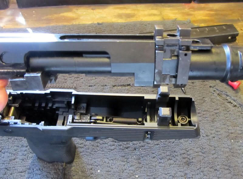

Is it that spring you can see on the lower reciever? The one with the VERY tight coils?

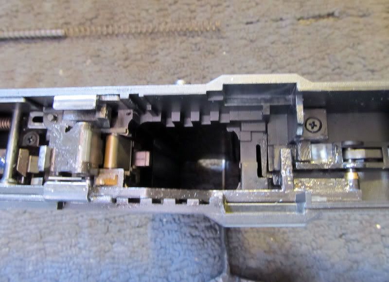

#11 dobey
dobey
  • 234 posts
  • Location:NY
Posted 20 February 2012 - 08:00 PM
The spring in that picture (which is my gun btw) is part number 73 and is not the one you need to stretch a little.  You want part number 162.
You can see it here just at the left side of the picture near that phillips head screw:
