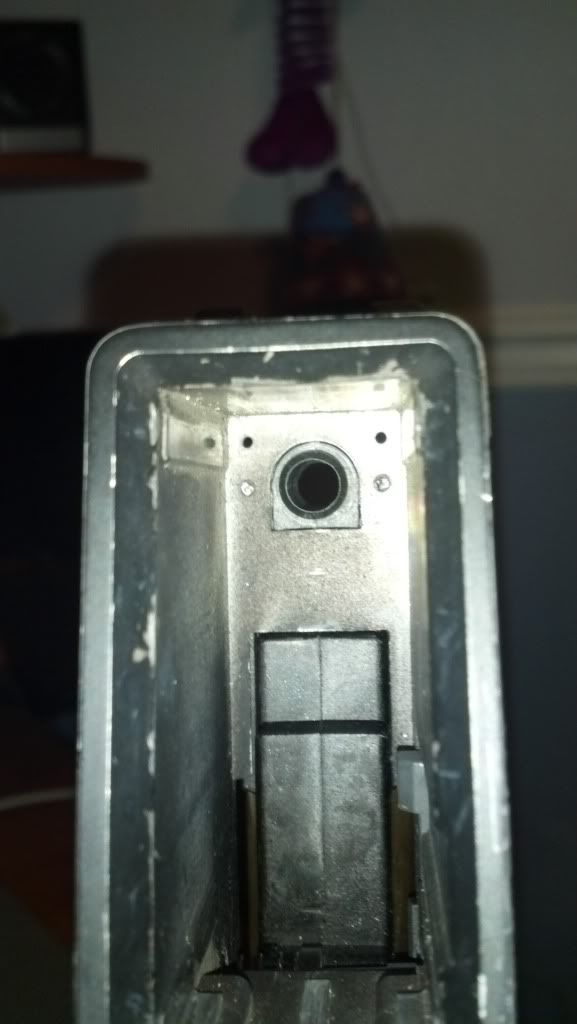

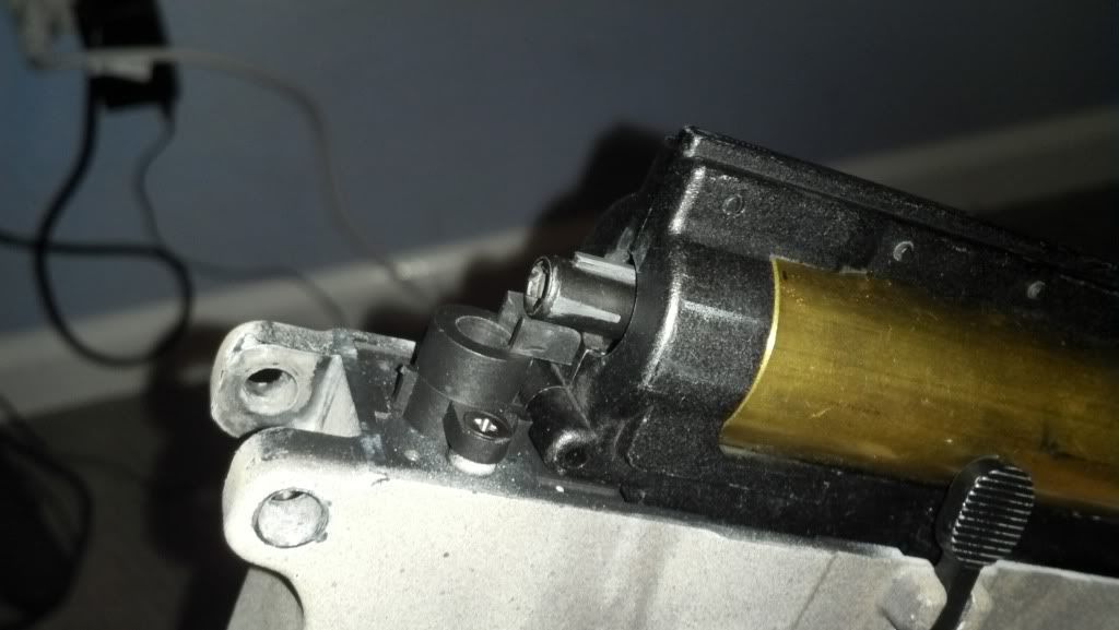

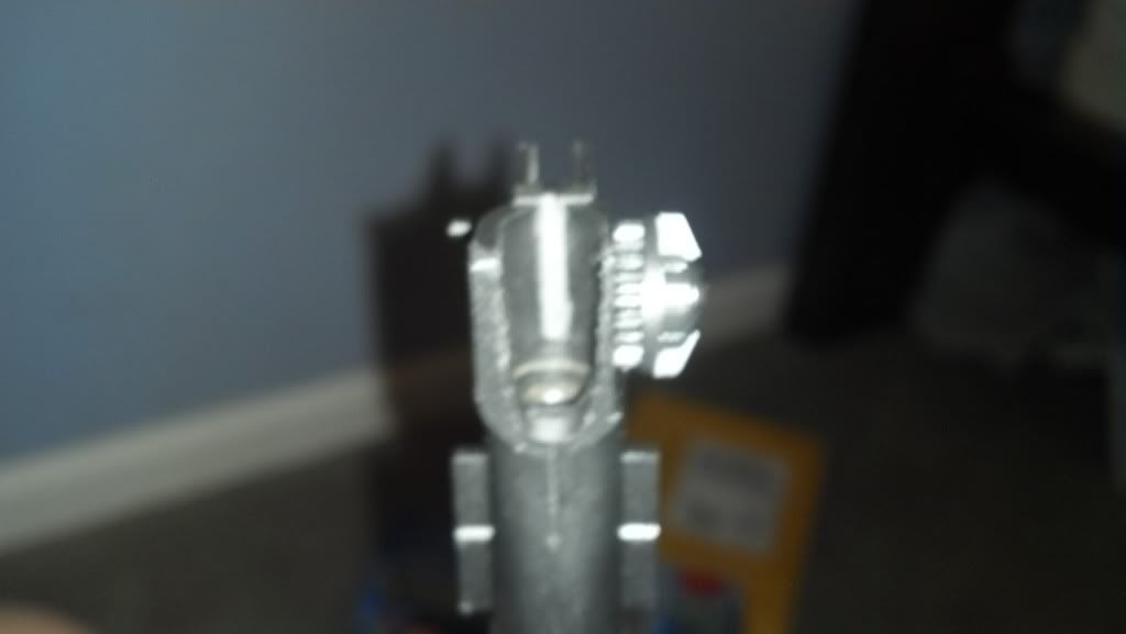

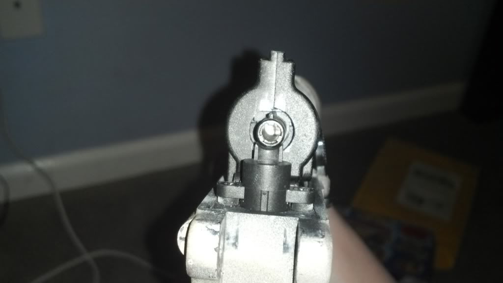

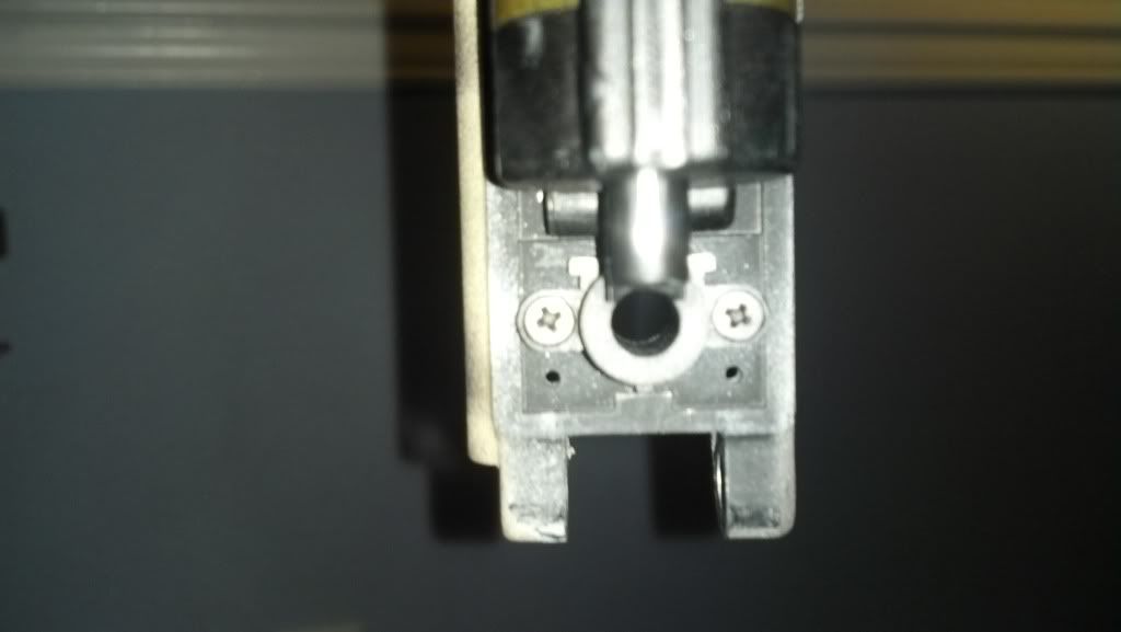

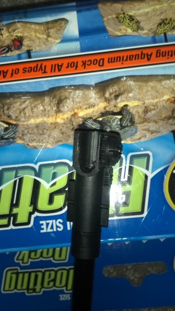

I am not sure if these will help you guys but hopefully it will.Posted ImagePosted ImagePosted ImagePosted ImagePosted ImagePosted Image

The picture of the hop up is blurry.

I have been using airsoft elite bbs and I can retake the picture of the hop up. I will probably look for a KWA mag in my house soon when i get back.

Hopefully this is image is clearer; please excuse the turtle background :,). Okay yesterday Desert was trying to help me and we examined the air nozzle and when I fired it, the nozzle passes just the hole but not the whole bb ramp. Unfortunately, I had to go so we could not examine it further. Hopefully this helps.

Did you try to modify your hop up by any chance? I see the left edges of the hop up to be worn down... Also what aftermarket barrel did you install?
Not only do I recommend you to use the KWA magazines, but to also install your original KWA inner barrel that came with your SR12.
I've seen feeding problems like you have spur from not only using non-KWA magazines but as well as pairing that up with aftermarket tightbores that changes hop up interacts with the BB.

I have to agree with GW. You hop up looks a little chewed up but not enough to cause feeding problems.
