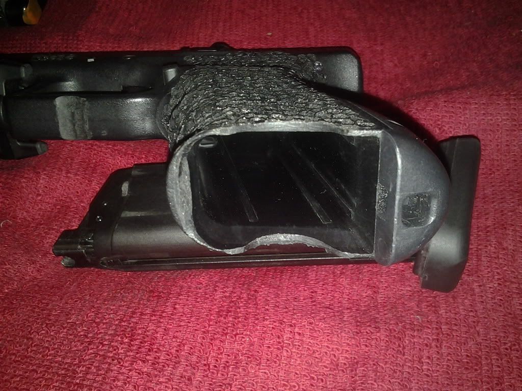

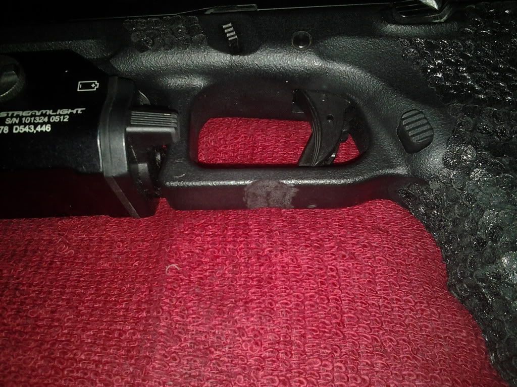

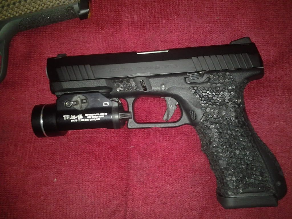

I have stippled, filed out a little of the mag well to aid in reloading(found the mags tended to catch on the flat part on the front so I smoothed and rounded that) dremiled a notch on the trigger guard so I get the same hold on it all the time, also cut a curve out of the sides of the bottom of the mag well I noticed with some minor sand the mags didnt pull free some of the times so this just aids in that. Heres some pics

Nice sequins on that lower. LIberace would love it.
