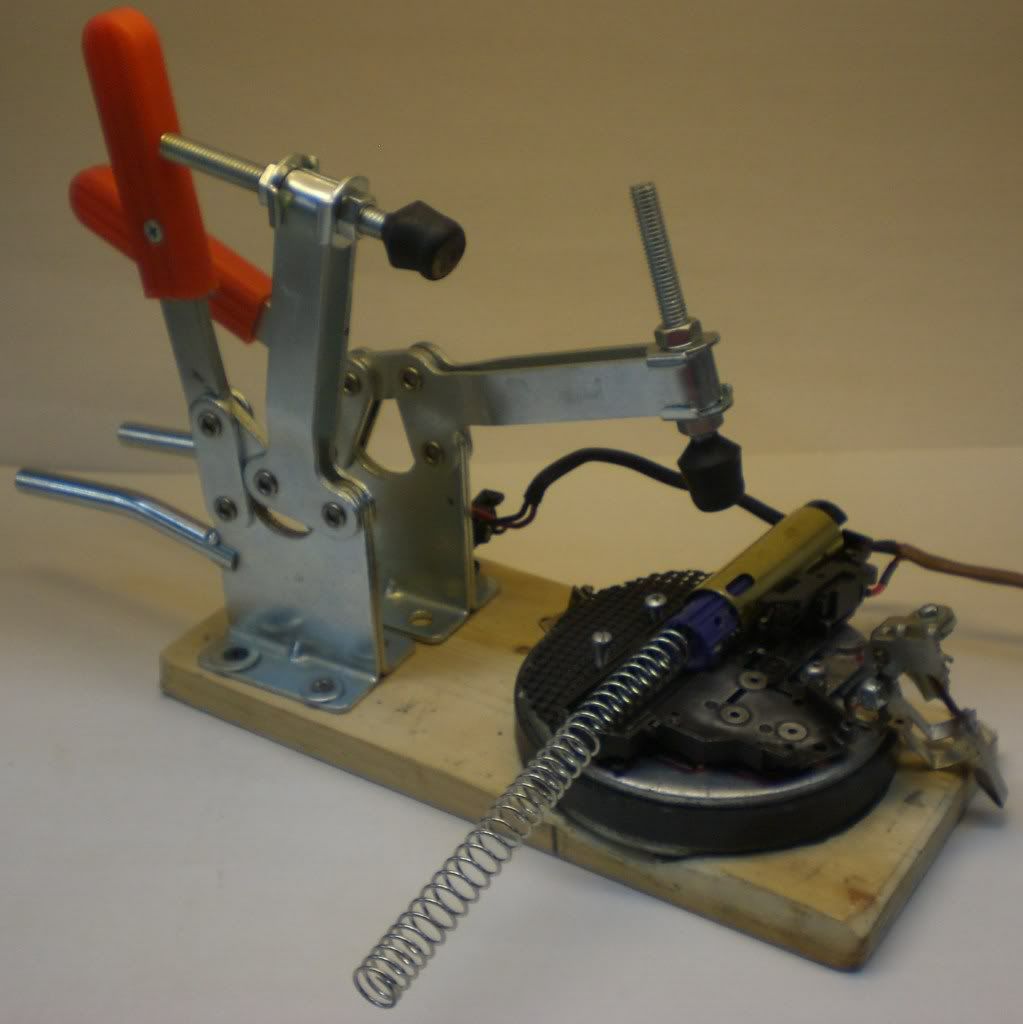

I can not tell you the respect I have for people who can put a GB together alone with their fingers as their main tool. I built this to hold things together while it get it ready to snap shut. Old speaker magnet keeps the gears and ARL true. Clamps keep the cylinder and main spring from popping out, little brades and do dads hold the trigger and tappet. Indespensible for me..

You’re absolutely right about the feeling you get when you hear the snap of the two halves as they finally go together. It took me about an hour for me to hear that sound. It's funny that you included the photo of the clamps because that what I was thinking I needed. I should have one constrcted by this weekend

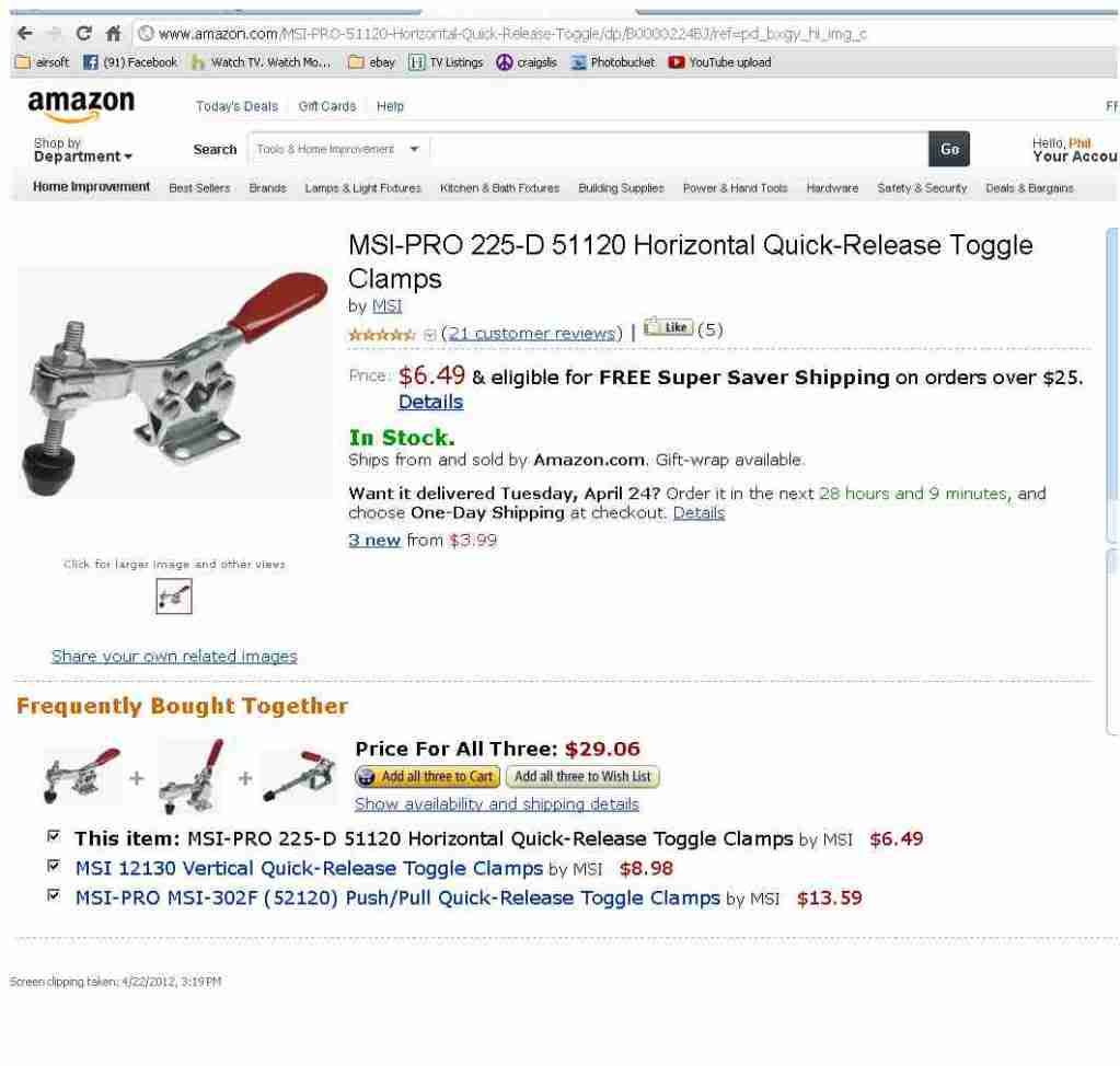

Here is a picture of something similar to the clamps I have. At least you can get a name and search for the size you need. Google Images works well for this. I had all that stuff in my workshop from something else long ago. I just looked around and MacGyver'ed it together. Do people these days know who Mac McGyver is?
If you got it together without a jig or another set of helping hands I salute you!!!!!!!!!!!

The clamps are just tight enough to hold the cylinder and spring but lose enough for the GB to slide around under them. Don't want to crush the cylinder.

The clamp works like a dream! I was able to change out the spring from disassembly to assembly in less than 20 minutes. When I compared the new spring with the old, it looks like they cut off about 2". Now with the new M120 spring, the gun is shooting 390, 391, 389 & 390 with 0.20 bbs and 349, 350, 350 & 349 with 0.25 bbs. Thanks for your help on this issue Philsaudio.
